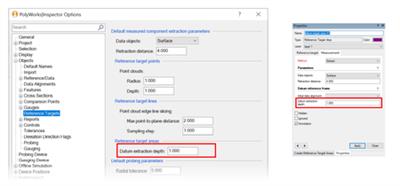

- When using the ISO standard, the fitting of a datum plane using datum target areas is now performed using a Chebyshev fit instead of a min/max fit. Items relating to this functionality have also be added.
. The Datum extraction depth text box has been added to the Measurement tab of the properties of datum target areas when the ISO standard is used. It specifies the depth to use when extracting the datum from the first contact point.
. The Datum extraction depth text box has been added in the new Reference target areas section on the Objects > Reference Targets page of the PolyWorks|Inspector Options dialog box. It specifies the default value of the Datum extraction depth parameters of datum target areas when the ISO standard is used. The default value is 1.

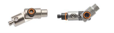

- The CNC CMM plug-in now supports standard Hexagon and Renishaw knuckle tool parts. Users can now add knuckles to their tool definition, to measure features that are difficult to reach with a straight tool. Knuckles are similar to extensions, but have one or two rotational joints depending on the model. This figure shows the possible rotations (highlighted in orange) for one- and two-joint knuckles. Both one- and two-joint knuckles are fully supported.
The user must therefore provide these angles when creating the tool, along with the mount rotation angle.
The mount rotation angle corresponds to the total angle of the mounting rotation and the upper knuckle joint rotation angle if a knuckle is used. The new joint rotation angle corresponds to the lower knuckle joint rotation. These parameters are offered when creating the tool.

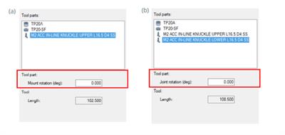

. The knuckle tool parts have been added to the list of available parts and can be added when creating the tool in the Create Tool dialog box, offered through the Probing Device Properties dialog box.
Once the upper knuckle tool part has been added to the tool definition, the Mount rotation (deg) parameter can be specified, as shown in (a
Once the lower knuckle tool part has been added, the new Joint rotation (deg) parameter can be specified, as shown in (b).
Both these parameters can be specified for individual tool parts. The parameters are therefore found under the new Tool part group label, when the corresponding tool part is selected in the tool definition area. All existing parameters relating to the entire tool are now found under the new Tool group label.
